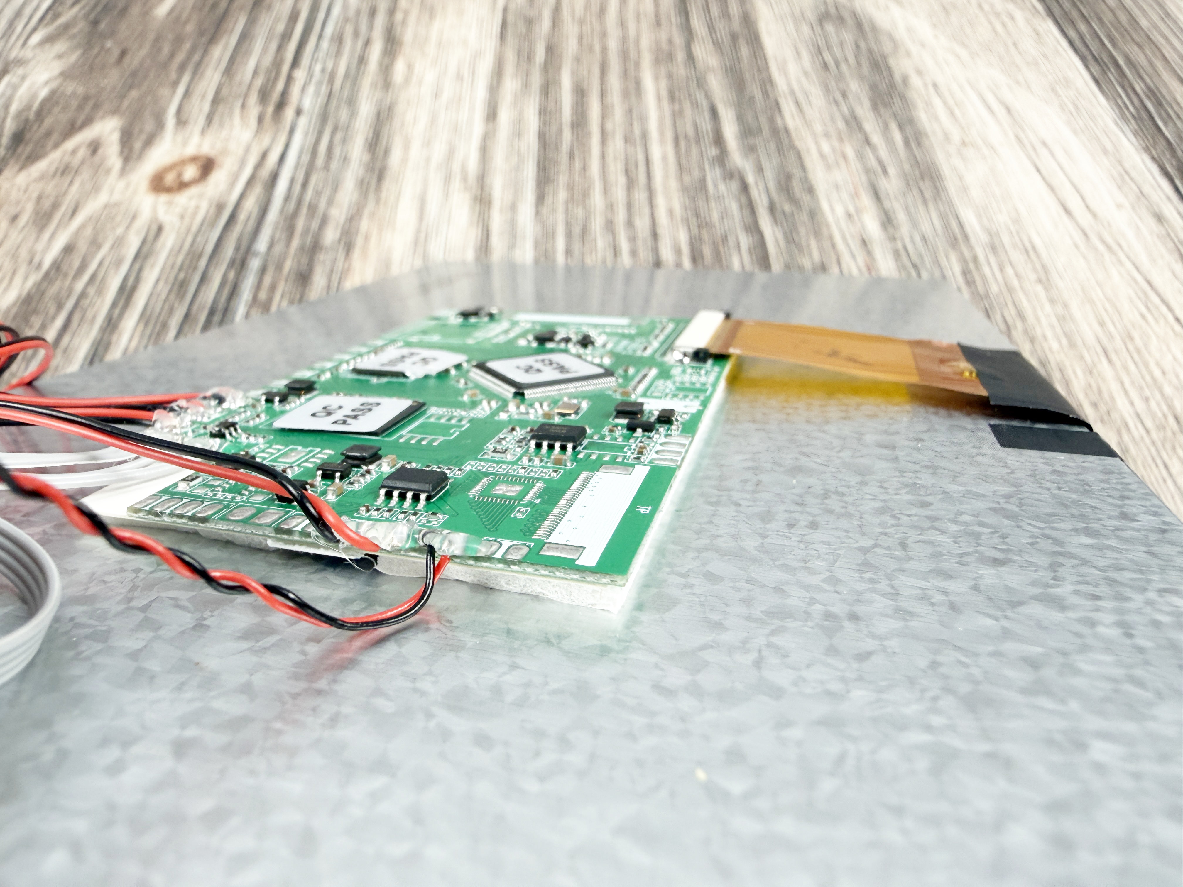

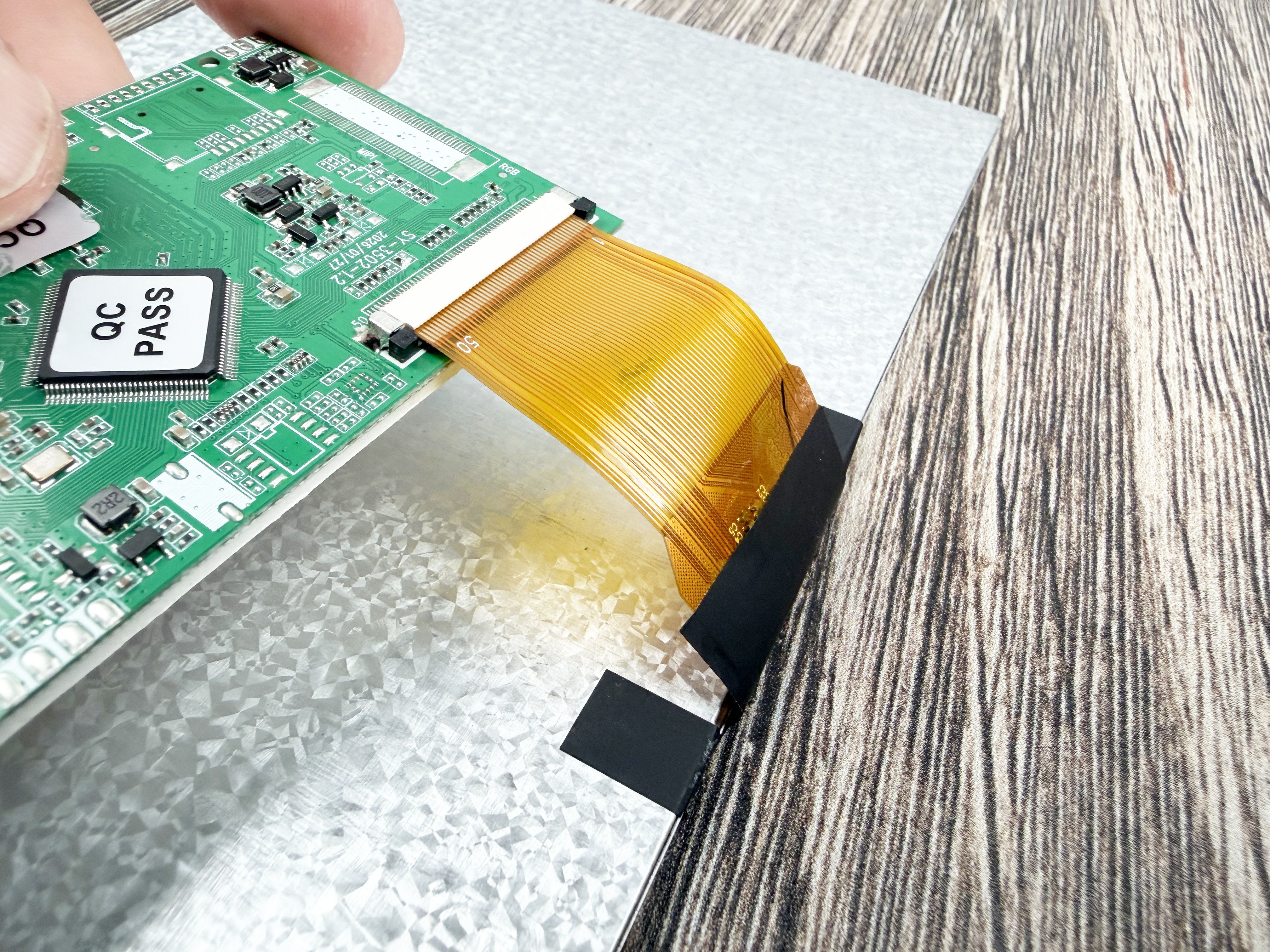

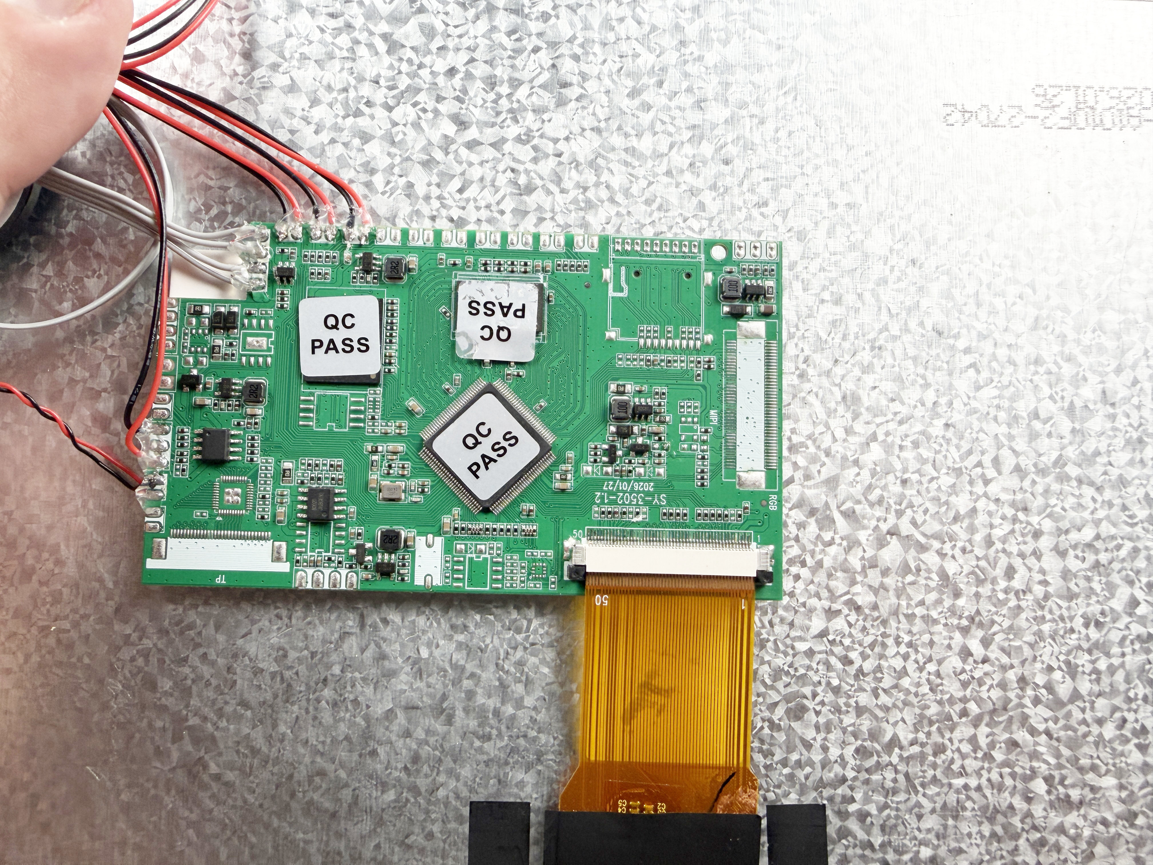

Your video player’s screen is attached to the main control board with a thin, flexible cable. The cable is yellow and is shown in the photo below.
Yellow flex cable connecting the screen to the control board.Because of the large size and weight of the 10" screen itself, you must take great care to make sure stress is never placed on the yellow flex cable.
To ensure proper operation of your player, it is important to observe the following special handling requirements when mounting, moving, or transporting your player:
- Always make sure the flexible cable is aligned straight as shown in the photo above, and also that the cable is fully inserted into the white plug on the main controller board as shown. The cable can easily tear or break.
- As shown in the photo above, there is a black tape covering some of the small electronic parts mounted to the flexible cable. If the cable is bent too tightly, this tape can come loose. Make sure the tape is pressed firmly onto the flexible cable and do not allow the tape to come off.
- When you mount the player into a housing or frame, do not bend the cable too tightly or it can break, its tape can come off, or the cable can tear.
- If you need to transport your player, make sure its main controller board is firmly attached to the screen (this was done using masking tape when your player was originally packed). If not firmly secured during transport, the cable can tear.
Please note that torn or damaged cables cannot be repaired or replaced!

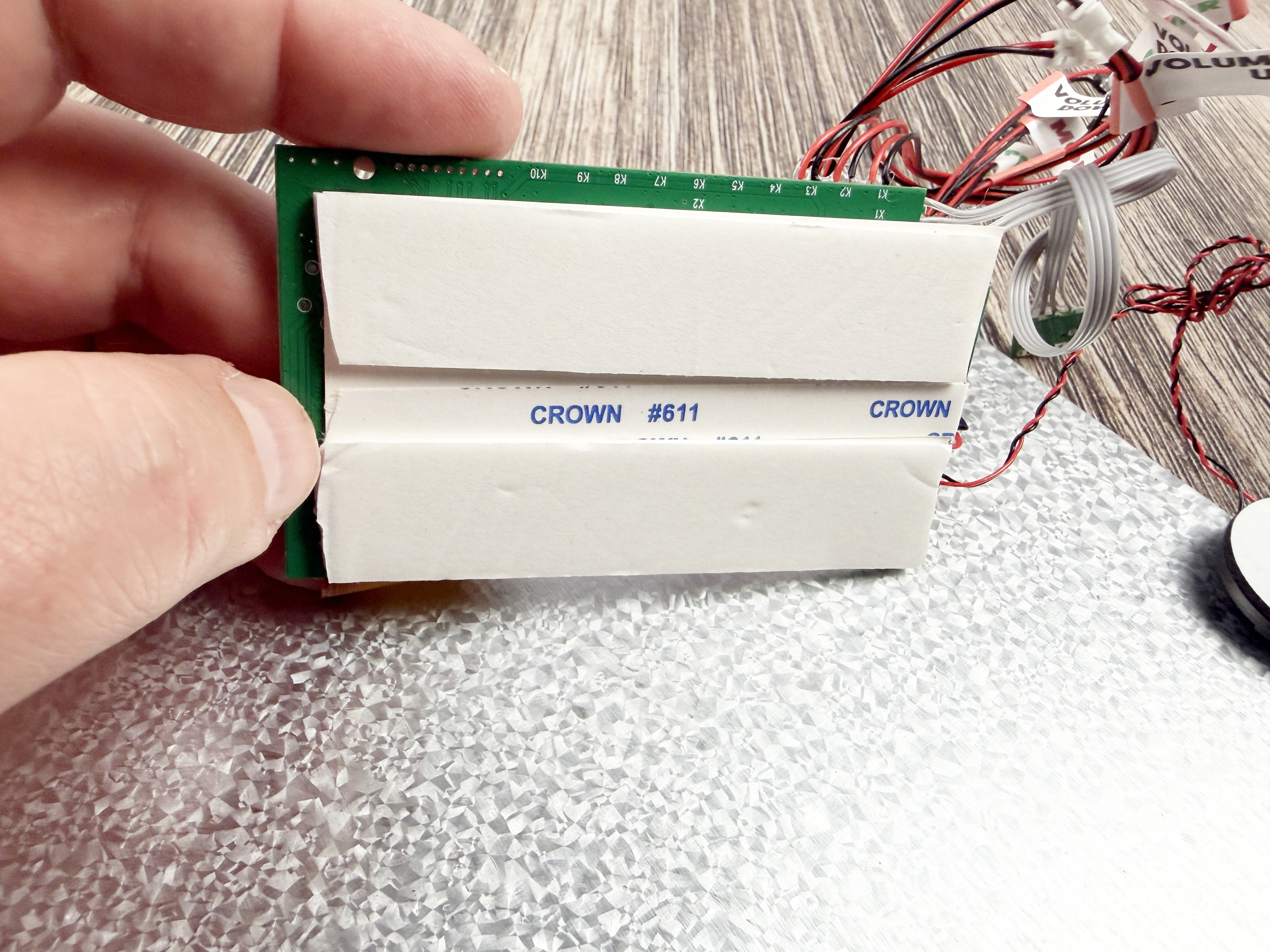

To ensure maximum safety for the flexible cable, we recommend attaching the main controller board to the back side of the video display using the double-sided tape that has already been attached to the backside of the controller board. See the photos below.
The double-sided tape on the back side of the main controller board.
Attach the main controller board with tape so the yellow cable is straight.
The controller board, attached.As shown in the photos above, firmly attaching the main controller board to the back side of the video screen so the yellow flex cable is straight and held in place will greatly reduce the chance of accidental damage to the cable over time.

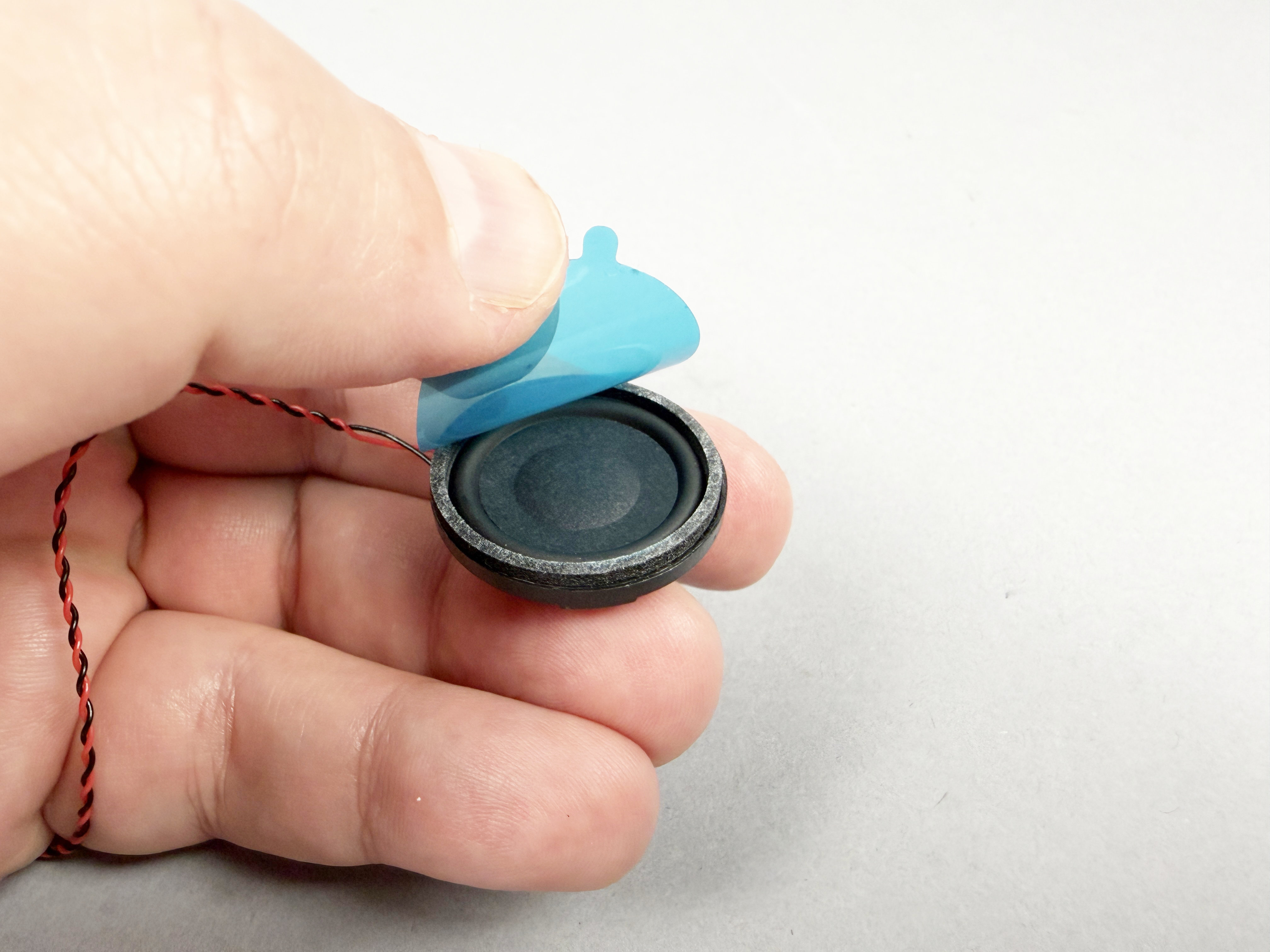

For video players purchased after July 2026, the speaker included with the player has a removable cover attached-- this is to protect the adhesive tape around the edge of the speaker. For best sound performance, it is recommended to remove this cover and attach the speaker to a flat surface with holes to allow sound to be heard.
We do not recommend sticking the speaker to a flat surface without holes-- doing so, or leaving the removable cover attached to the speaker, will result in muffled sound. It may also be difficult to remove and re-position the speaker at a future time once it has been mounted.

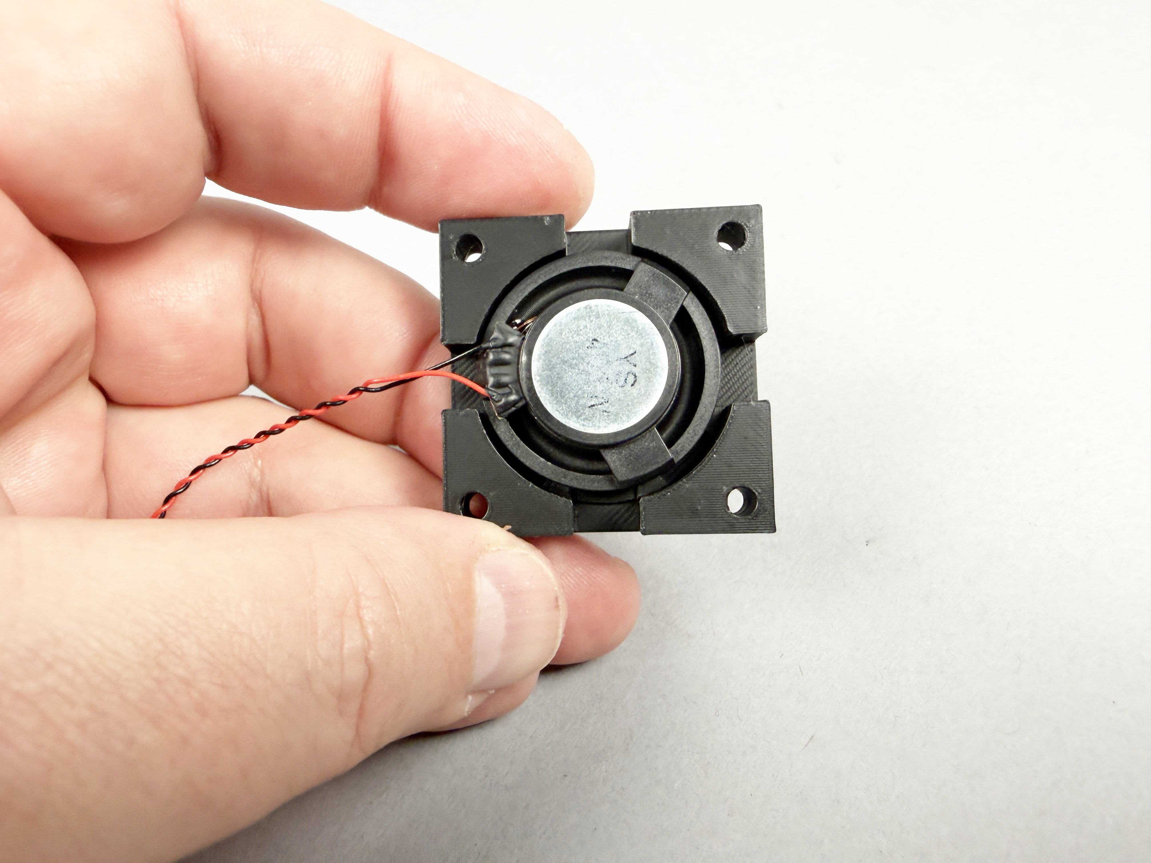

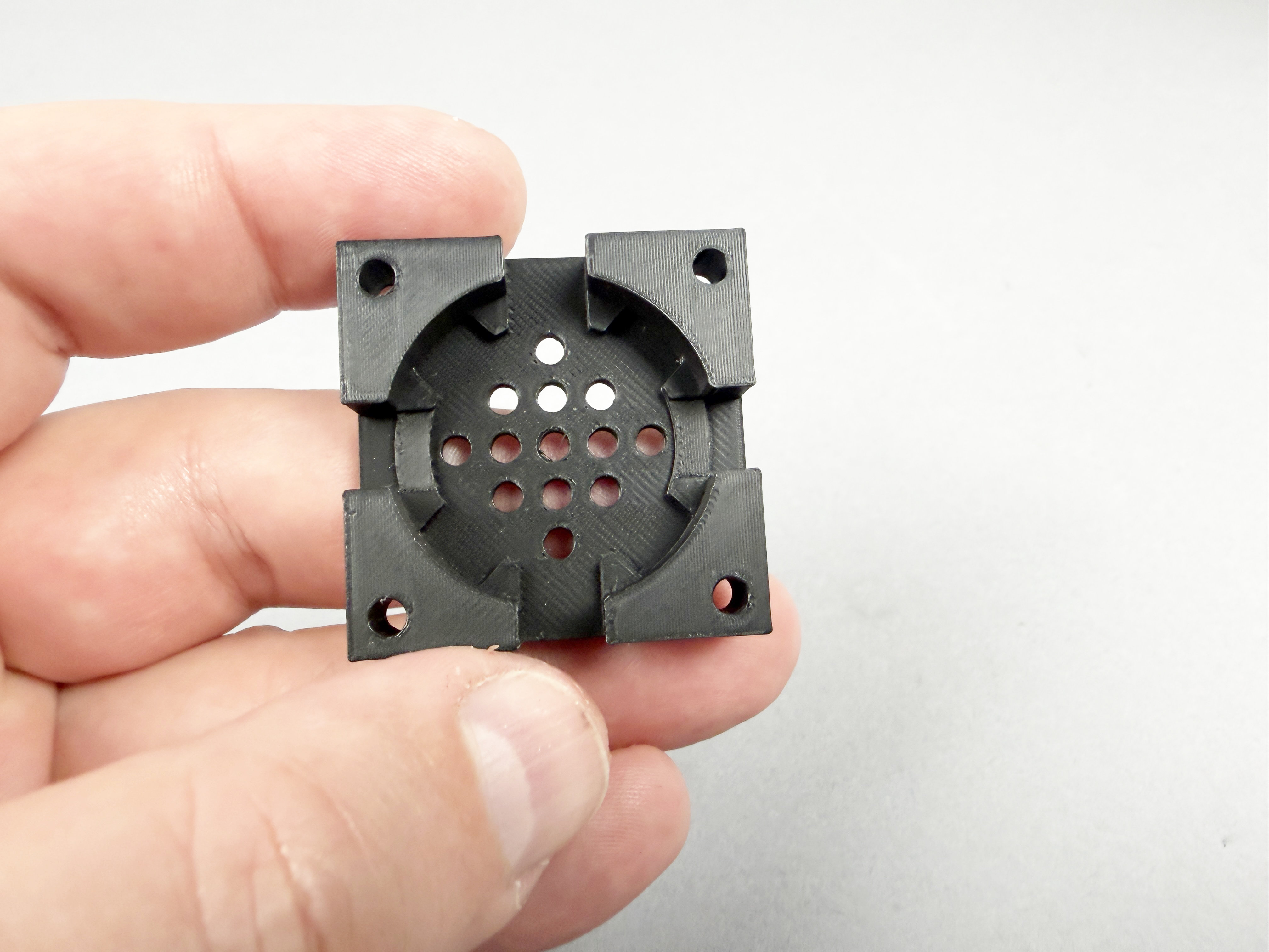

To allow the speaker to be mounted in a way that will allow maximum sound fidelity, we have designed and included a special 3D-printed speaker enclosure:

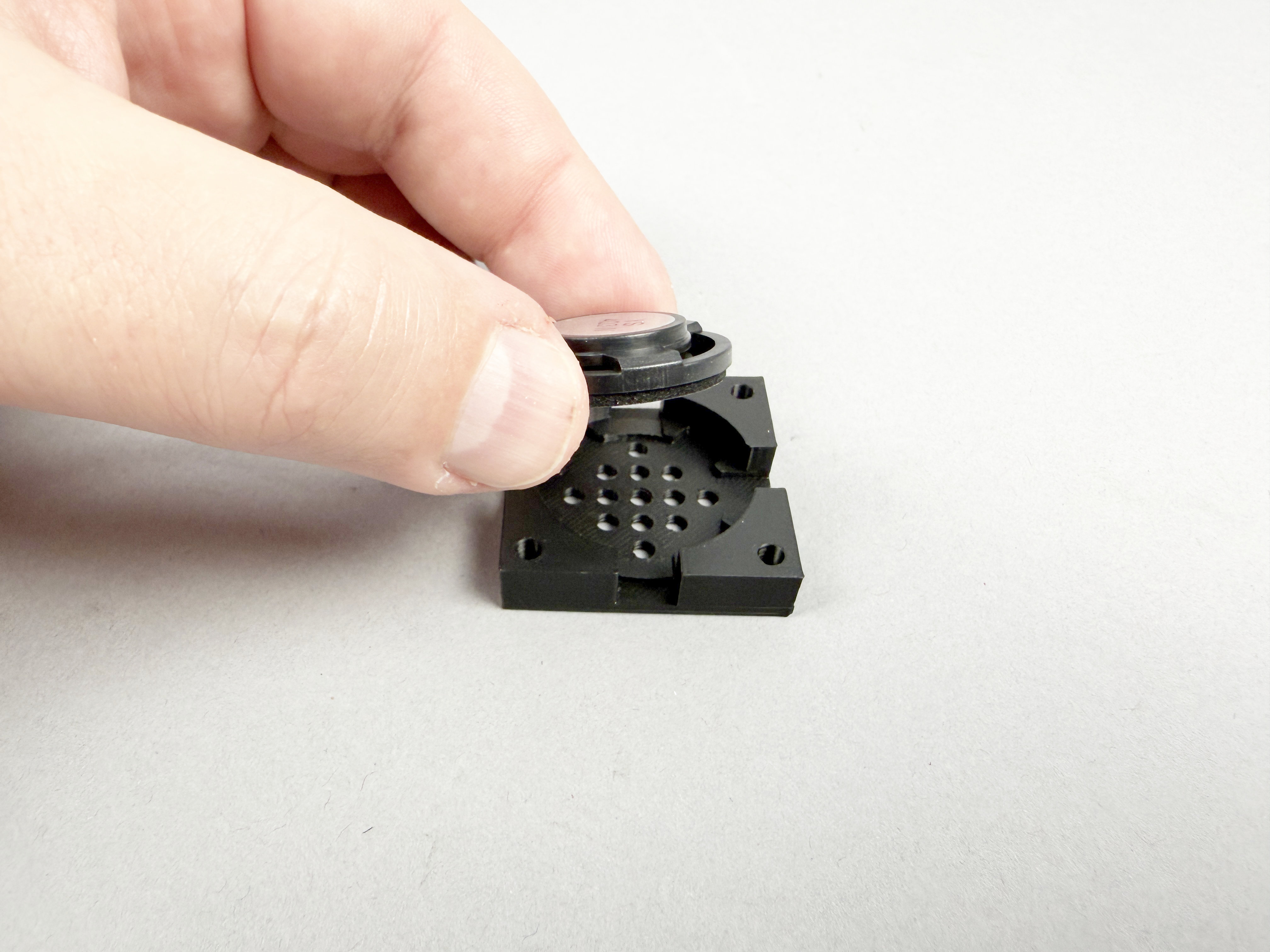

3D-printed speaker enclosure.To mount your speaker inside the enclosure, carefully remove the adhesive cover and press the front of the speaker into the center of the enclosure as shown in the photos below.
Removing the adhesive cover.
Mounting the speaker inside the enclosure.
Speaker mounted inside enclosure.
Be careful not to touch the adhesive around the edge of the speaker while mounting it.

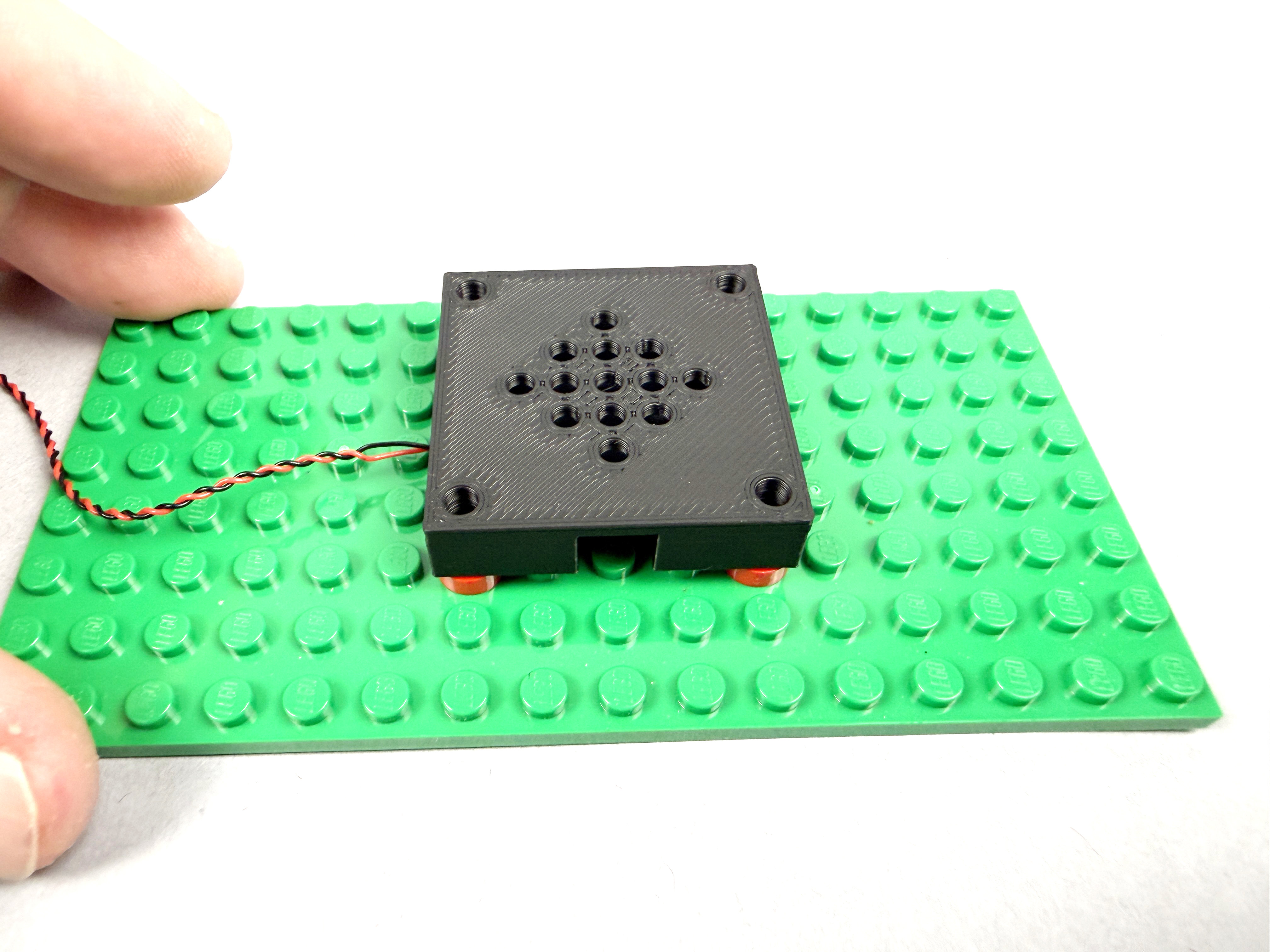

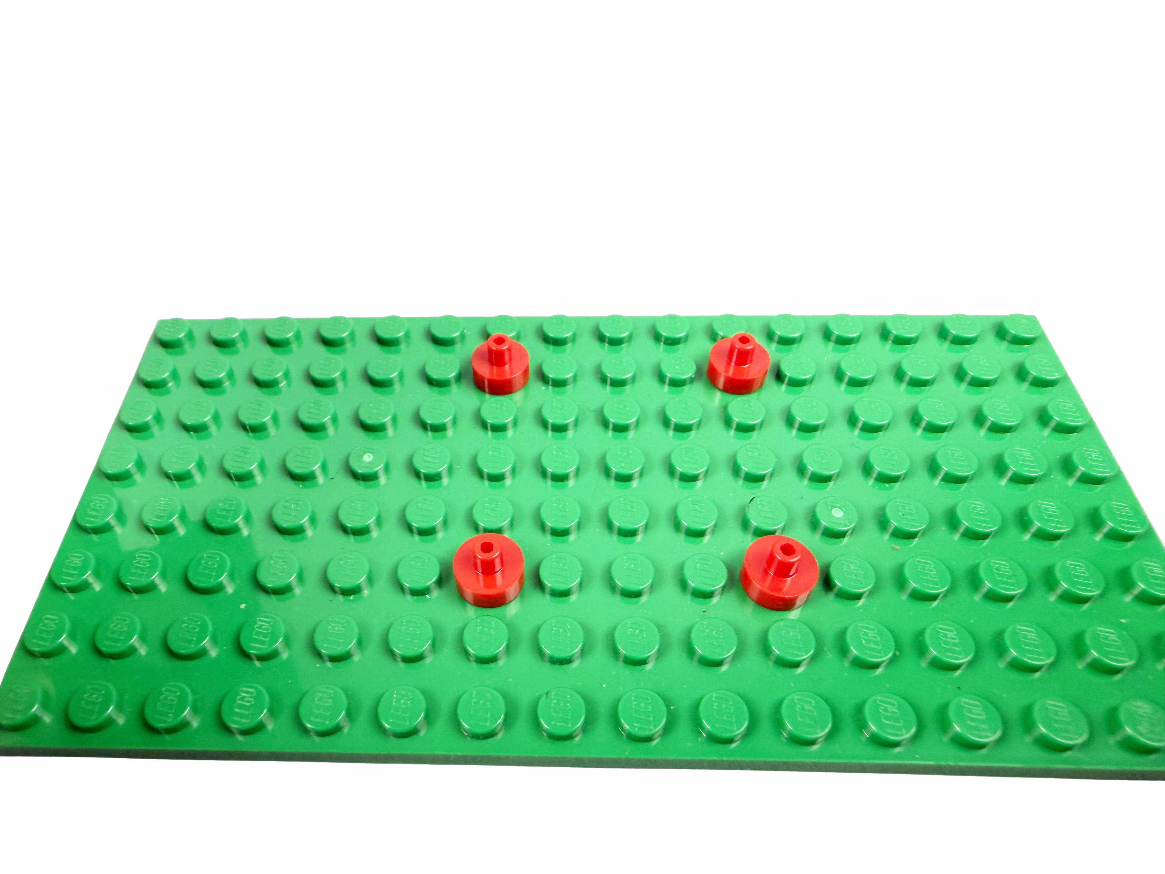

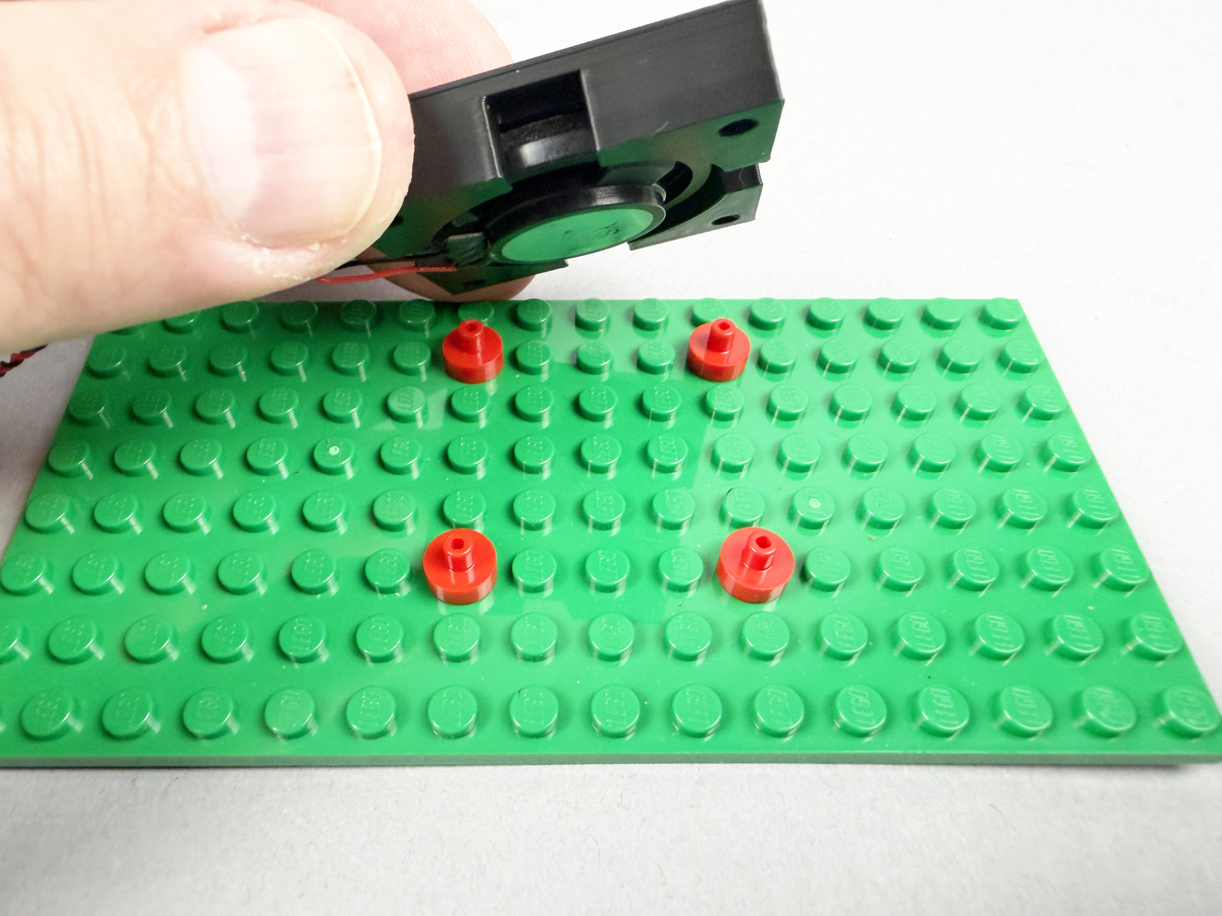

The enclosure has four holes which can be secured with screws (not included), or you can also attach it to a LEGO® plate using four "1x1 round tiles with bar and pin hole" (LEGO® part number
20482, not included):

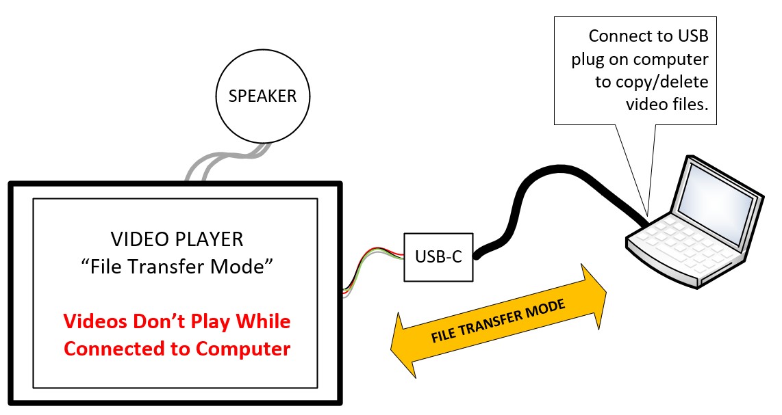

To add or change video files on the player, follow these steps: (also see the figure below)
- Using the included USB cable, connect one end to the USB connector cable on the video player, and connect the other end to your computer. You should see the video player appear as a connected memory disk, like a USB memory stick would appear when connected.
- Open the folder representing the video player, and copy/delete files as needed.
- Disconnect the USB cable from your computer and connect/re-connect to your external power source. As explained above, the player will not play videos when connected to a computer.
Connecting the video player for file transfer.

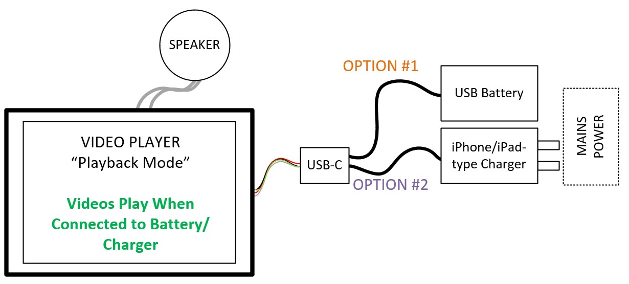

To operate the video player, connect it to a power source as shown in the figure below. Once connected, the video player will begin playing its stored videos (depending on the selected playback mode).
Two options for powering the video player module.As shown in the figure, there are two main options for powering the video module:
- Connection to a USB battery bank using the USB cable included with this kit.
- Connection to an iPhone or iPad-type charger (connected to mains power) using the USB cable included with this kit.

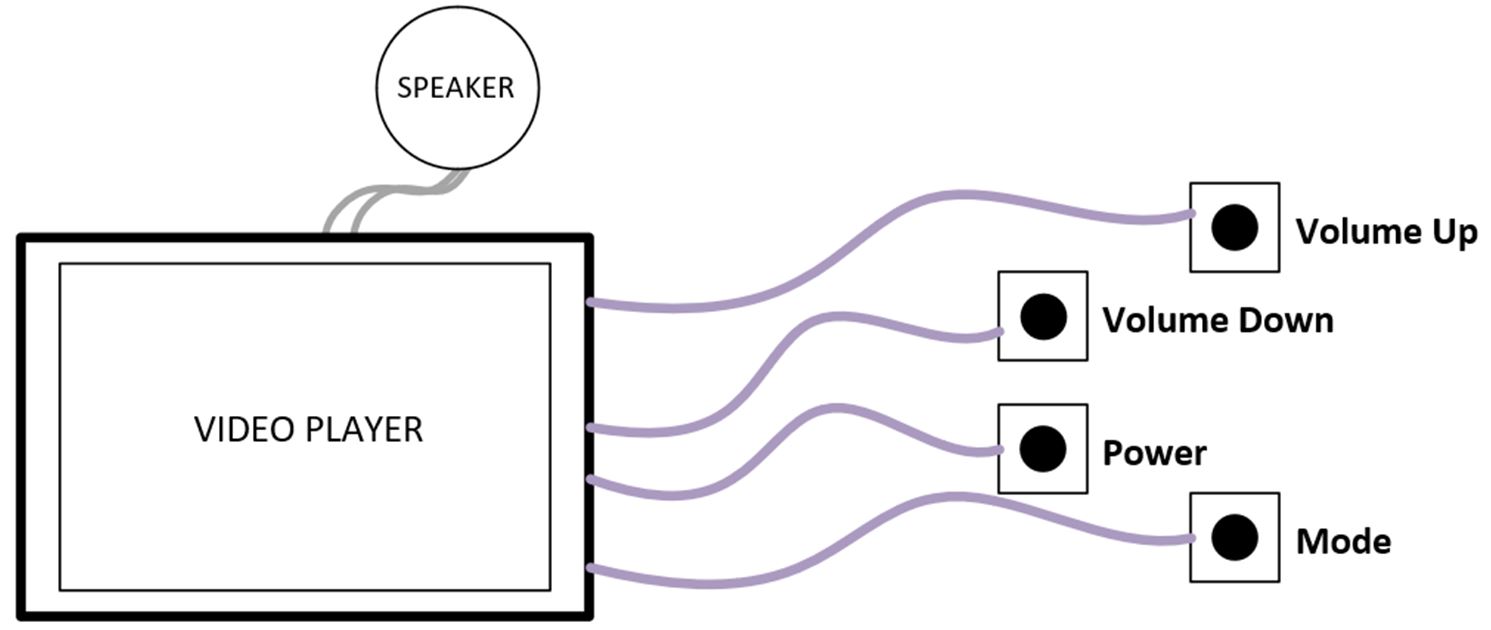

Your video player has four buttons connected to it via wires with plugs that can be disconnected (in case you want to replace with your own type/size of button). Each button wire has a paper label attached. The figure below shows the buttons connected to your player:
- Volume Up: increases playback volume.
- Volume Down: decreases playback volume.
- Power: turns the video player on or off. (NOTE that the video player continues to use power even when it is turned off with the Power button)
- Mode: switches between your player’s three playback modes:
- Normal Loop: videos play in a continuous loop.
- Random Loop: videos play in a random order and in a continuous loop.
- Play Once: videos play through once, then the player’s power turns off. (NOTE that the video player continues to use power even when it automatically turns itself off)
Video player buttons.Settings made using the buttons are saved in the video player’s memory even when power is disconnected.

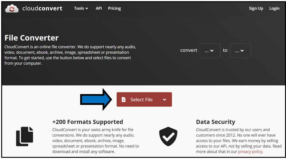

If your video files are not in MP4 or AVI format, or if they are too large to fit into the video player’s memory, you can adjust these aspects of the files using a free online file conversion tool called
CloudConvert. To access this tool, open a web browser on your computer and navigate to
https://www.cloudconvert.com/.
Next, click the red “Select File” button on the main page to select the video file on your computer and upload it. (see the blue arrow in the screenshot below)

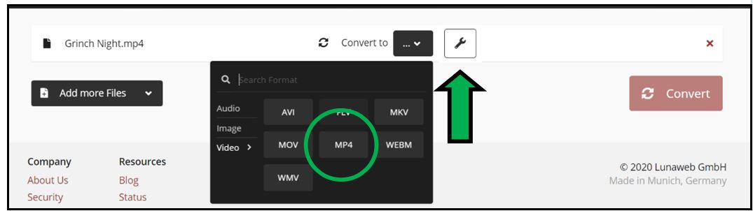

Selecting your video file to convert.Once you have selected your video, you will have the option to select the type of video file to convert to.
For maximum compatibility, we recommend converting to the MP4 format.
Once you select MP4 as the file format, you will see a wrench icon appear (see the green arrow in the illustration below). Click the wrench icon to open the “Options” window.
DO NOT click on the “Convert” button.
Selecting the conversion format.

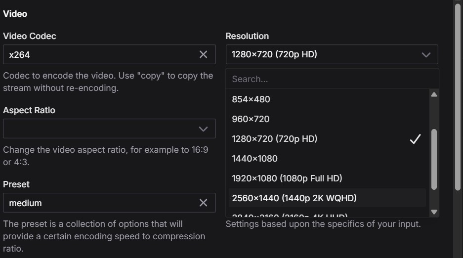

File conversion Options window.The video player’s resolution is 1024x600. To make sure your video plays well on the screen, we recommend converting your video to the 1280x720 (720p HD) resolution as shown in the screenshot above.
If your video is very high resolution (4K/8K, etc.), the video player may have trouble playing it. The player tries to re-size each video frame in real-time; as long as your videos are close to the player’s resolution (either above or below), playback should work well without needing to re-size. If you notice significant lag in playback, or if the player won’t play your files even if they are in MP4 or AVI format, you may still need to run them through the online converter to reduce their resolution. This will also reduce their file size, meaning you can fit more videos onto your player!
