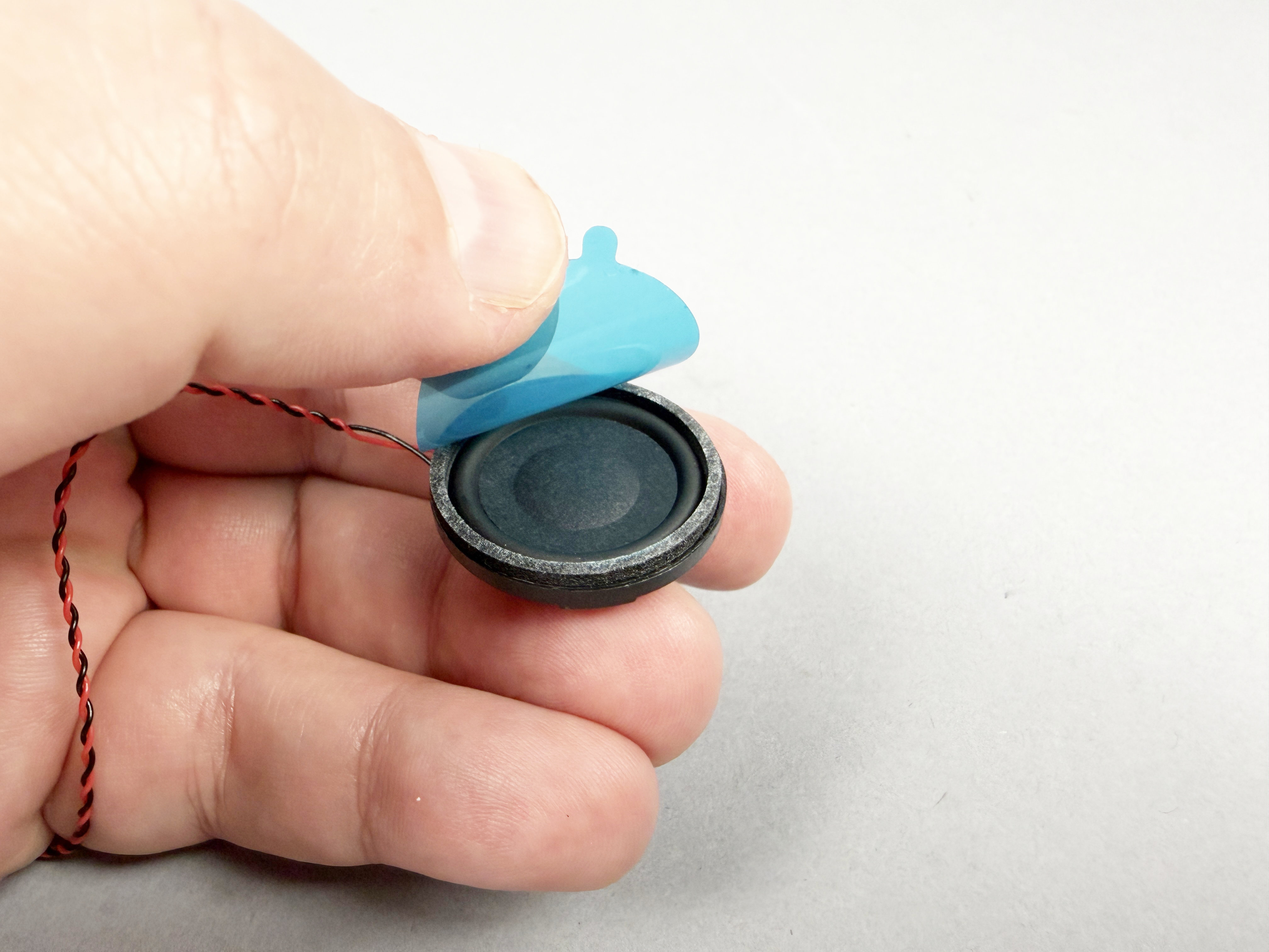

For video players purchased after July 2026, the speaker included with the player has a removable cover attached-- this is to protect the adhesive tape around the edge of the speaker. For best sound performance, it is recommended to remove this cover and attach the speaker to a flat surface with holes to allow sound to be heard.
We do not recommend sticking the speaker to a flat surface without holes-- doing so, or leaving the removable cover attached to the speaker, will result in muffled sound. It may also be difficult to remove and re-position the speaker at a future time once it has been mounted.

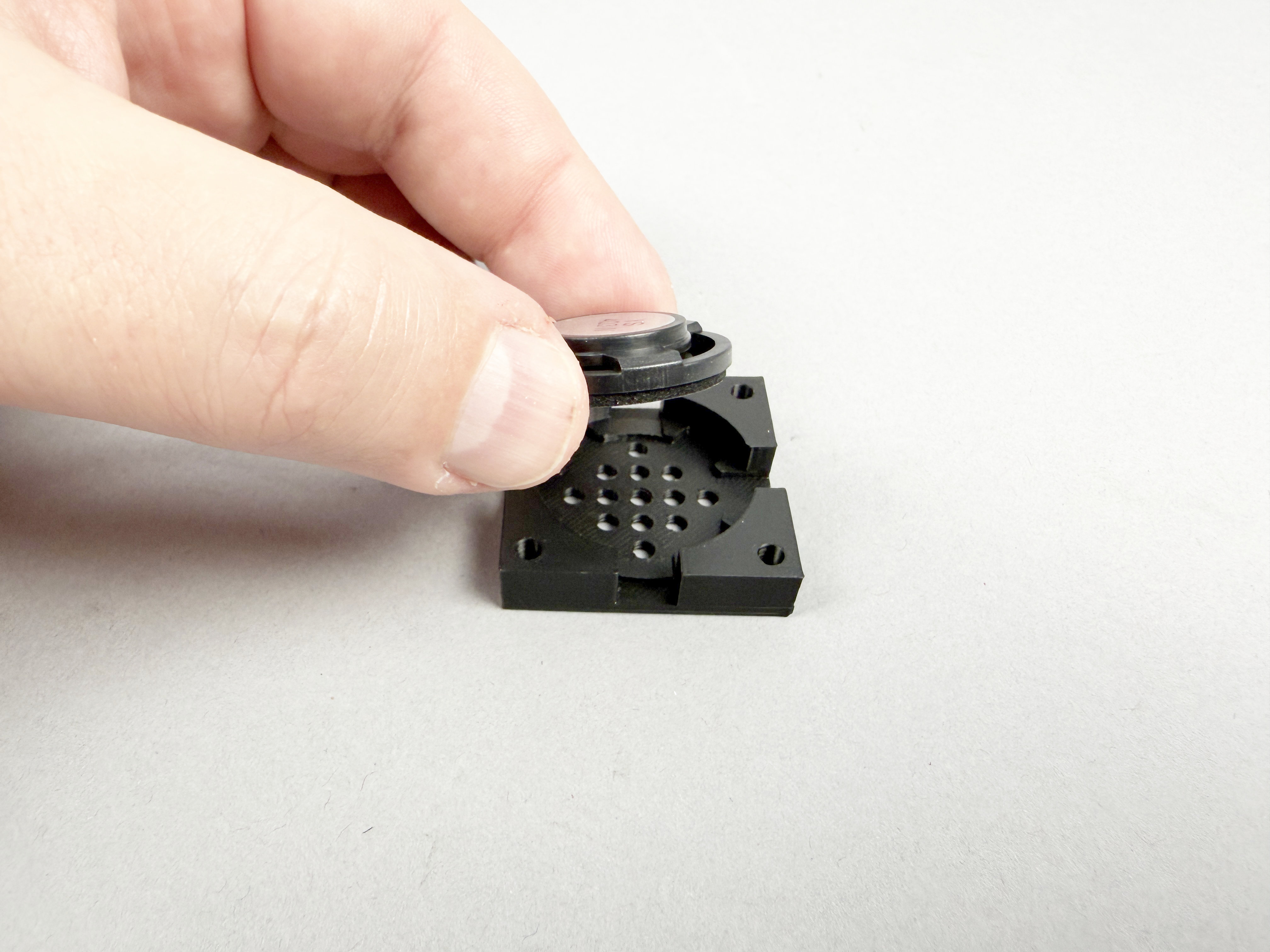

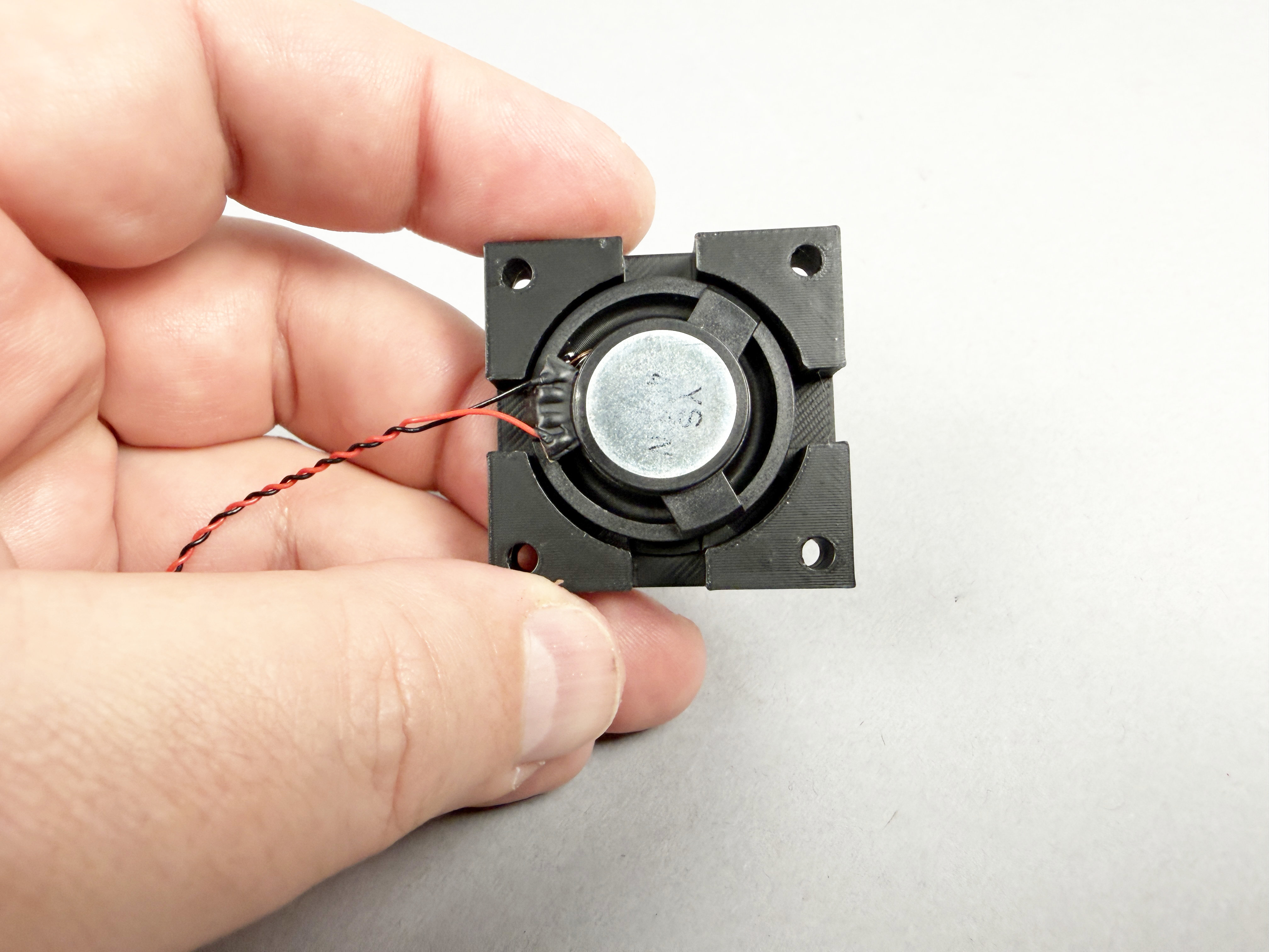

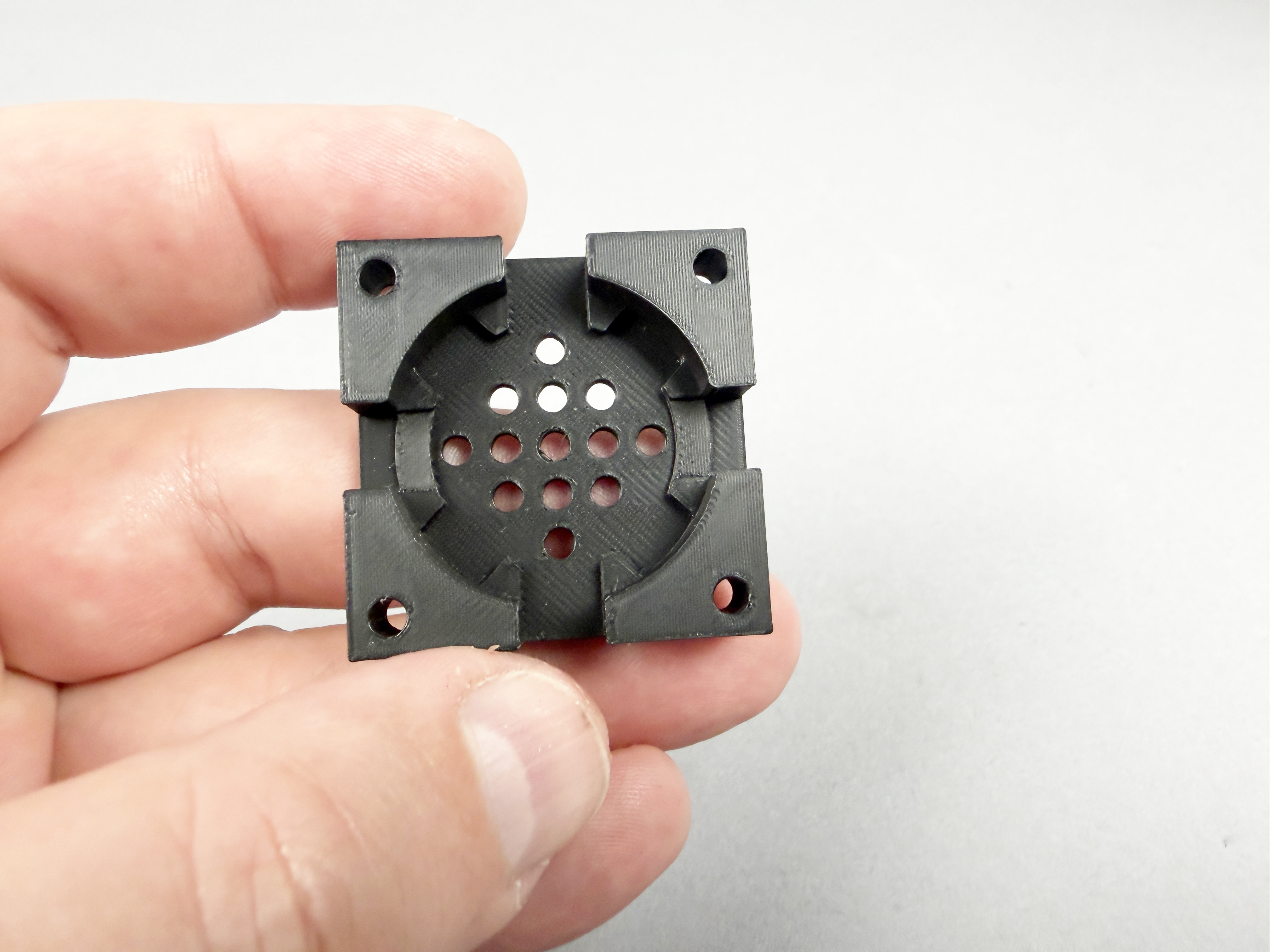

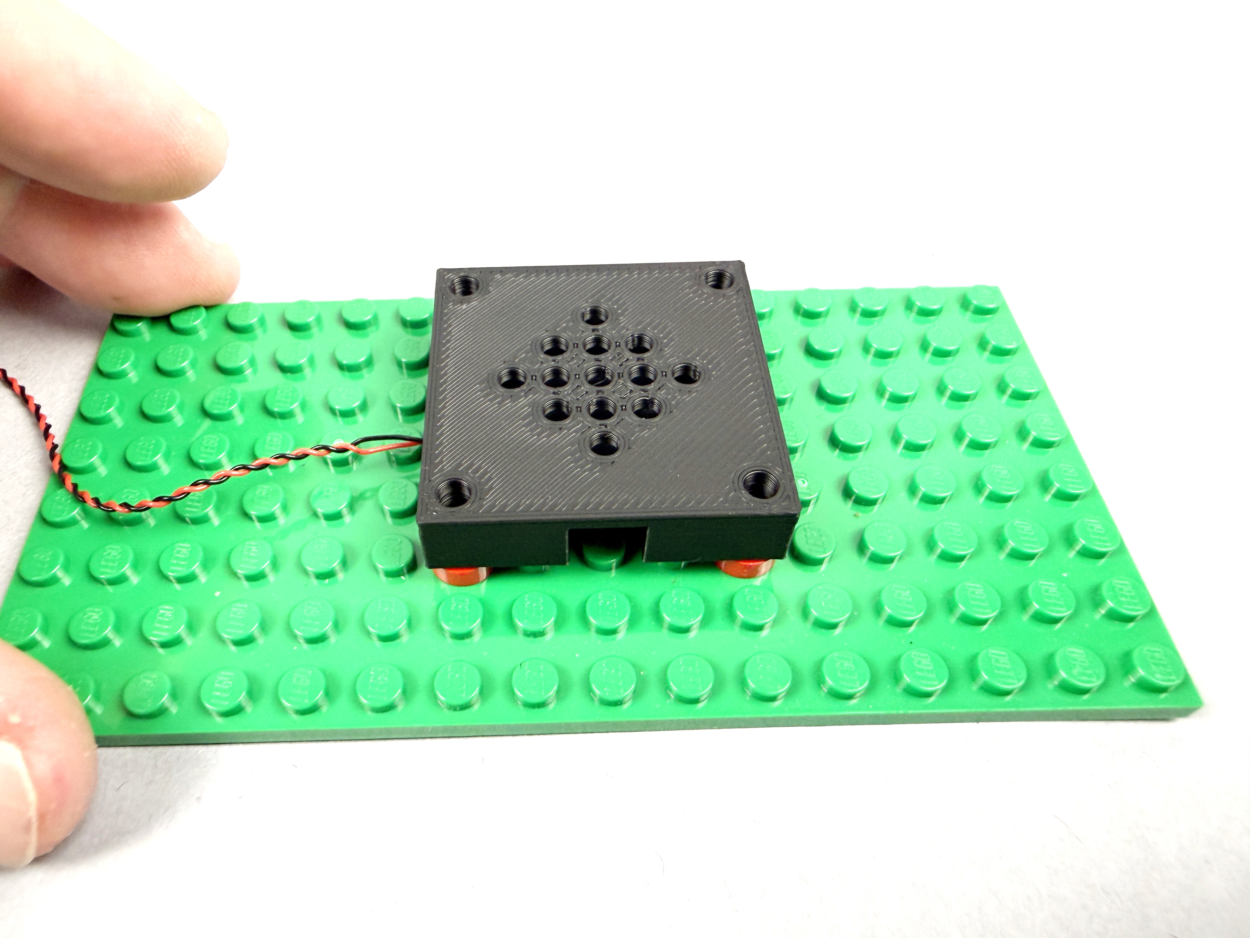

To allow the speaker to be mounted in a way that will allow maximum sound fidelity, we have designed and included a special 3D-printed speaker enclosure:
3D-printed speaker enclosure.To mount your speaker inside the enclosure, carefully remove the adhesive cover and press the front of the speaker into the center of the enclosure as shown in the photos below.

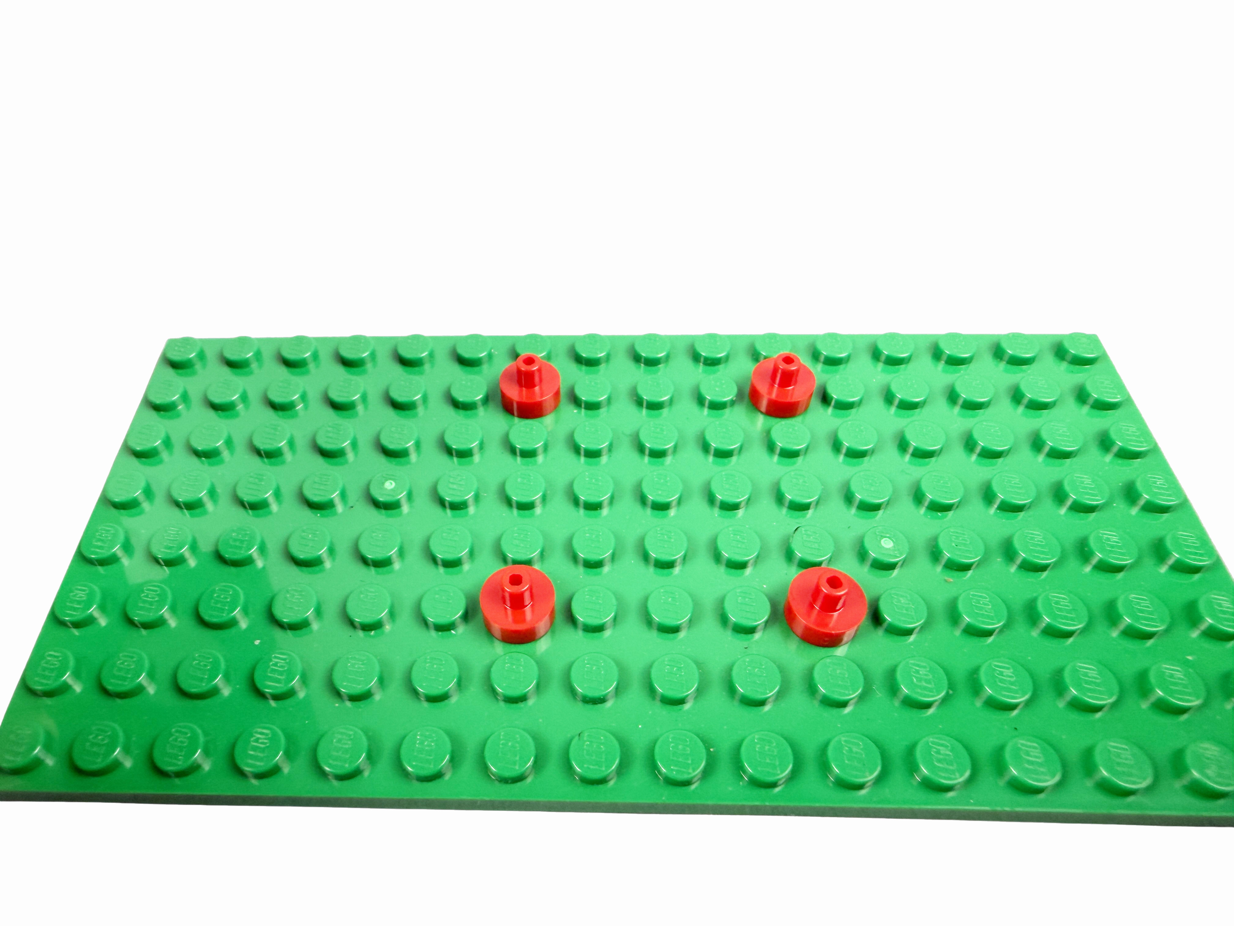

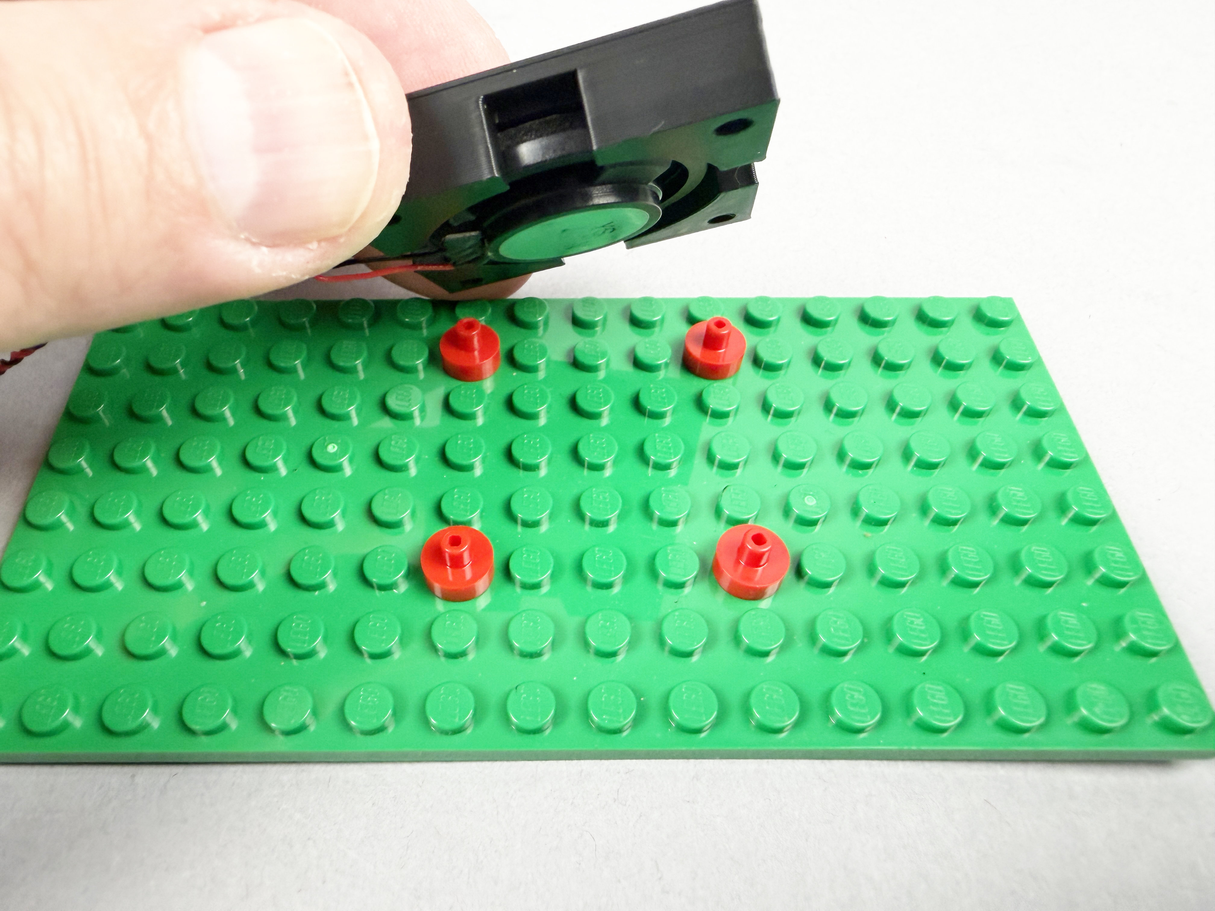

The enclosure has four holes which can be secured with screws (not included), or you can also attach it to a LEGO® plate using four "1x1 round tiles with bar and pin hole" (LEGO® part number 20482, not included):

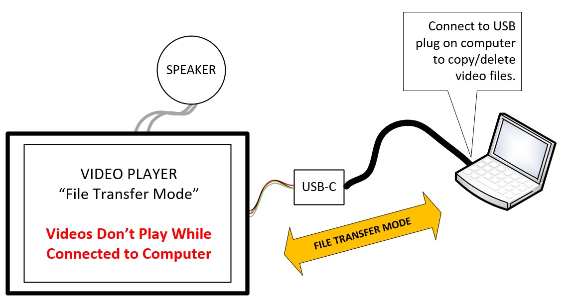

To add or change video files on the player, follow these steps: (also see the figure below)
- Using the included USB cable, connect one end to the USB connector cable on the video player, and connect the other end to your computer. You should see the video player appear as a connected memory disk, like a USB memory stick would appear when connected.
- Open the folder representing the video player, and copy/delete files as needed.
- Disconnect the USB cable from your computer and connect/re-connect to your external power source. As explained above, the player will not play videos when connected to a computer.
Connecting the video player for file transfer.
If you are using an Apple/Mac computer and you delete files from the player, you will also need to complete the steps to “empty” the trash container corresponding to the drive of the video player. This is because Mac computers place deleted files in a hidden directory on the player and the deleted files will continue taking up space until you “empty” the trash container on the video player.

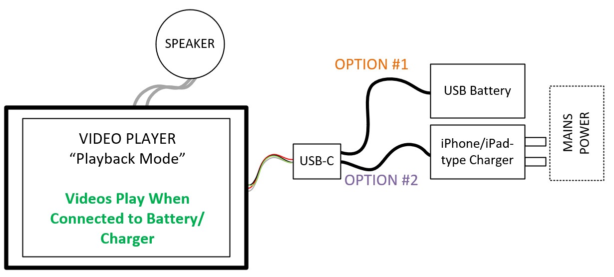

To operate the video player, connect it to a power source as shown in the figure below. Once connected, the video player will begin playing its stored videos (depending on the selected playback mode).
As shown in the figure, there are two main options for powering the video module:
Two options for powering the video player module.
- Connection to a USB battery bank using the USB cable included with this kit.
- Connection to an iPhone or iPad-type charger (connected to mains power) using the USB cable included with this kit.
