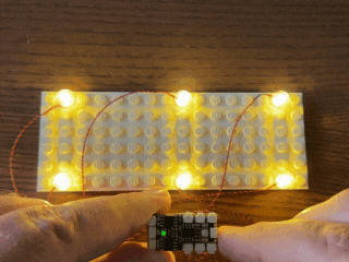

The burned-out bulb effect lighting controller has six outputs, each of which has its own random flicker/burn out effect.  This effect simulates the flickering of a broken bulb, with a randomly-selected "burn out" time when the light turns off.  You can connect up to six LED lights (sold separately) to the outputs of the lighting effect controller.
The illustration below shows the main parts of the lighting effect controller.

Below is an animation showing the effect in action:
Demo of the flickering and burning out effect.
